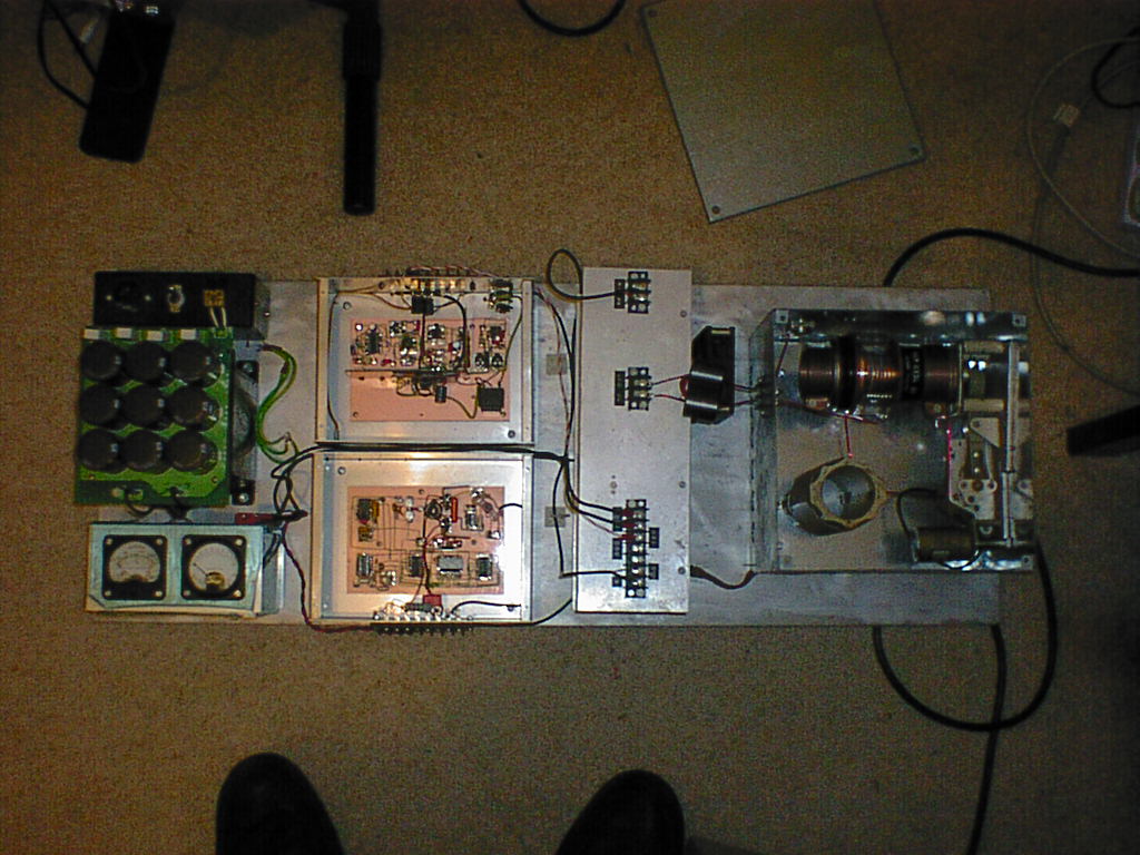

Hello MRF,
Thank for your signal report and mp3 files.
I can confirm that you received the signal of Energy Power AM
1395 KHz broadcasting from Dublin Ireland.
The station started six years ago and broadcasts mainly on
weekends to the greater Dublin area. We play on Medium wave as there
is no other service available in Dublin on this band which so many radios can
receive.
The playout system runs on a PC with around 2500 music
tracks along with station Id's plus jingles.
Our transmitter is a workship built 330 watt solid state unit employing
the PDM (pulse duration modulation) scheme of generating Amplitude
Modulation.
A picture of it is attached for you.
It gives a very loud and high quality audio on a receiver
tuned to the TX frequency. There is alot of information on the web regarding
this AM method so I need not go into further detail.
The Antenna is a 1/8 wavelength vertical with top hat and tuning coil
to bring it to 1/4 wave resonance on the operating frequency. This is
placed over a 17 spoke radial ground system with 8 grounding rods.
The strong field radius from the antenna is around 15 Km over which
the program gets in very well even on insensitive receivers.
This relitively short radius is more than enough to cover Dublin city
however
Our audio is processed with an Orban 9100a Optimod which keeps
the modulation level always up at 100% while maintaining very good audio
quality.
The transmitter is fed with a VHF link from the programme source. This provides
a major degree of RF isolation between the TX and the audio source.
I hope this information is of interest to you. Do not hesitate to contact
again if you want further clarification on anything to do with Energypower AM.
Best regards to you,
John Power - Energy Power AM , MediumWave 1395Khz

Berichten: 1993
Re: Energy Power AM from Dublin on 1395 kHz
Grappig zendertje.
Misschien eens een schema vragen?

Een aantal jaren geleden heb ik ook de eindtrap gezien.
Deze kwam bij anorak nation voorbij.
